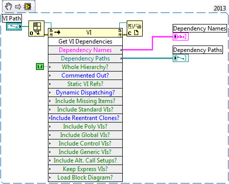

Try this:
That will get the paths to all the VIs.  It will not get the dlls.  I'm not sure how to do that.
