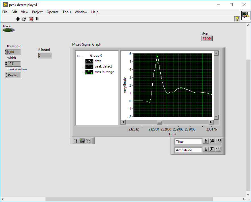

Read the help for peak detection to learn how it work (fitting a square function)
one possible way:
do a peak detection with a reasonable peak point width
with the resulting array enter a for loop to find the single point max value in that range (again about the same width choosen before)
going for a single value peak is always prone to noise ...
here is something to play 🙂
Q&D 🙂
Greetings from Germany
Henrik
LV since v3.1
(5,769 Views)
Thanks Henrik, this is the solution I searching for, haha However, out of curiosity, is there any other way of using 'Max and Min' and Loop without the peak detector? Thank you once again.
