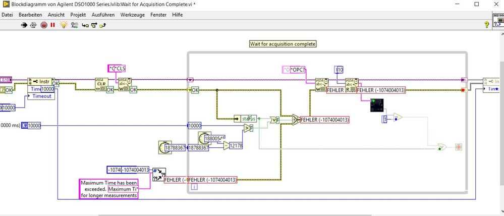

the error says : erros -1073807339 in VISA:Read in Agilent DSO1000 Series.lvlib:Wait for Acquisition Complete.vi->Agilent DSO1000 Series.lvlib:Read Waveform (Single).vi->Agilent DSO1000 Series Acquire Waveform Continuously.vi
Possible reason: Visa : timeout expired before operation complete. so I opened the VI that gives the error and

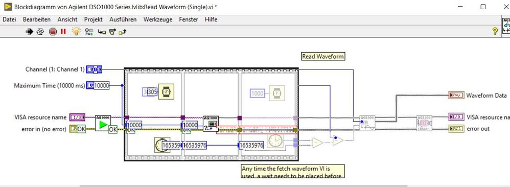

saw this
so I opened the VI that gives the error again and had this
I think everything that uses a Visa read is not working and everything that just uses Visa write is working but I don't know why,
it says that maximum time has been exceeded so I kept increasing the Maximum timeout but nothing changes

Hi achouch,
you got that TimeOut error in your first image: so the Agilent is not responding (fast enough)!
That second image with error -1074004013 is irrelevant: that error cluster is just created in case it might be needed inside the case structure. The VISA functions in this image clearly show an "OK" up to the point you made that screenshot…

I changed the third image I hope this one is more relevant

Hi achouch,
what should I do
- check for correct responses with other commands (like all those initialization stuff)
- set a larger timeout value
- check, if your device allows to request for a "measurement completed" message (by reading it's Programmer manual!)
