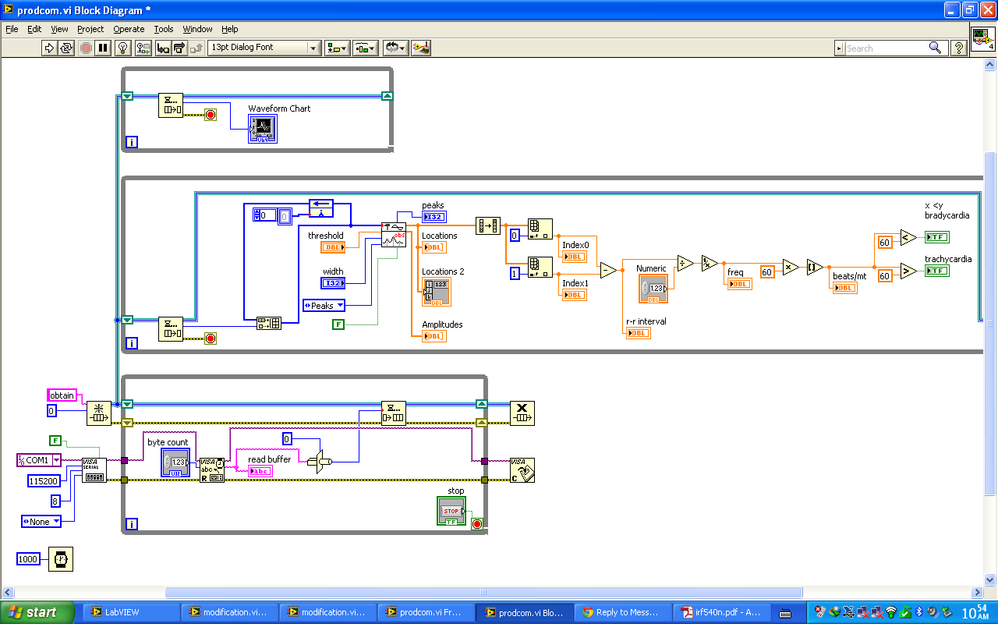

Hello everyone,
Thanks for replying, Actually i found a reason which i want to share with you to get a better solution.
I was previously building the program using multiple producer consumer loops in which one was generting the data, the second was plotting, and the third was analyzing and calcualting the threshold voltage.
As in this pic

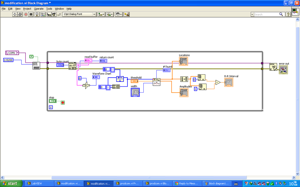

Latter i formed a new vi, in which i made all these things happen in a single while loop like this
From here what i came to know that when the reading gets fluctuate (the calculation value) i actually gets error in the vi(New bits arrived earlier error of VISA).
I removed the connection between the visa read and the build array function and then there wasnt any error in the vi(New bits arrived error of VISA).
I think that the time required to do the calculation produces error in the output. Because whenever the error occurs (in calculation) and i stop the vi, it gives an error output (of VISA) of new bits arrived earlier.
So, now can anyone pls give me the solution for it.
As i already deployed the producer and consumer loop to sepreate the production and calcuation and the same error comes when i combine all the operations in a single while loop.
I shall be very thankfull to all who replied.
Regards
Message 4 of 8
(3,546 Views)

Dear billko
As I wrote in my first post that I was working on Peak Detection in an incoming signal to find out the frequency of it.
The problem occurring in my first vi was that it was detecting some points as the peaks while they were not.
Also mention here that it always occur after some time. I.e.. It works perfectly for a certain time but then start counting some points as peaks which are not the peaks.
In order to get resolve the problem I made the vi in a single vi and concluded that what I think that the time is taken in calculating the peaks creates delay in getting the serial data and then it start counting the areas which are not peaks as peaks.
How do I concluded this was because, I disconnect the incoming data from the Build array (which you can see in the second vi) and then the vi runs accurately (i.e.. A new data arrives before the previous) in the VISA communication.
Also when inaccurate points are detected as peaks I stop my vi immediately and gets the error of VISA communication.
So some problem I think lies in the time of calculation that remains present in the producer consumer technique too.
Thanks a lot.
Regards
Message 6 of 8
(3,515 Views)
I still stand by my post that the original architecture isn't what was wrong.  I think your "extra bytes" at the port are actually leftover data that wasn't read from the time before!  Here is an excerpt from VISA read:
VISA Read Details
This function might return less than the number of bytes requested if the function reaches the end of the buffer, reaches a termination character, or if a timeout occurs. The output error cluster indicates if a timeout has occurred.
[edit]
I believe that sometimes you are reading before all the data is in the buffer.
[/edit]
What you need is to figure out a method to wait until there are the necessary bytes at the port before placing it in the queue.  There are various examples here and in LabVIEW itself that show you how you might do this, depending on how the data is formatted.
Bill
CLD
(Mid-Level minion.)
Message 7 of 8

Finally working on the first vi I found the solution of my problem
The reason I got for the changing value of the rate was that filled array, i.e. with time the array gets more and more values in it and it took time to work on it and as a result the vi giving wrong results of the rate.
I finally limited the value of array and then passed that limited array to the producer consumer section for calculation and then it worked correctly.
I request all to reply me whether i took the right way to the solution.
Thanks to all who helped me in getting a solution.
Regards
