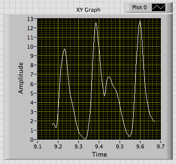

I just looked at the data you posted earlier (test data.txt). When I plot it on an XY graph I get this:
What results do you expect for this data? I am not asking what your code produce, but what would you get if you analyzed it manually.  For example the highest peak appears to be at (9.60, 12.72). What other peaks and valleys do you expect? There is a small inflection point at (9.465, 5.85). Is that something you need to detect? What about the little "wrinkles" below 9.2?  Is this data from the V vs Freq. graph or from a different part of your program?

I need to detect the highest peaks, for example, the one around 9.38 and the one at 9.6. When I run an experiment I might see the peak at, for example, 9.42 but the software will see it at 9.4. This is a problem wheni am trying to write a very specific frequency to the generator, as the signal I will get with 9.4 is not as strong/noise-free as the one I would get with 9.42
I don't think the orthogonal fit is the problem because we have two versions of the program; my version and the unstable version that was written by some other guy 6 years ago. His version uses the orthogonal smoothing as well, and would display a peak at, for example (this is actual data from a test), 9.427 and when I ran the same test on my program i got 9.409 GHz. I had my mentor take a look through all of the code with me and we do not have the slightest idea why his program is more accurate than mine. It seems that as illogical and sometimes plain silly his program is, the one are where it's better than mine is the accuracy.

I know how NMR spectrometers work, but I am not as familiar with the physics/chemistry of the samples and how that relates to the spectrum you get.  The three highest peaks in the data you posted all look quite symmetrical, although the datapoints do not necessarily hit the highest point of the peak.  I ran the peak detector on that data and found that the data is not sensitive to the peak width over the range of 3 to 10 points.  This is consistent with the visual appearance of the data.
