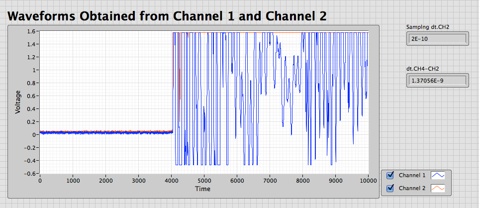

Okay, I have two waveforms. I need to detect the moment when signal exceeds a certain threshold (e.g. 0.2V). Then to do so with another channel waveform and finally compare them to find time difference. I am interested only in first rising edges.
Yes, I have read the white paper.. I think it worths to try Threshold Detector.vi as well.
I do understand difference between a threshold and a peak. I need a threshold, you are absolutely right..

@Ivan899 wrote:
"According to them" - according to datasheets I mentioned above. "System" - is VI we are trying to optimize.
Thank you very much!Smiley Happy I am going to try  to find the reason why we interpret the same datasheets in different way and why graphs differ so significantly.
There is no differance between your datasheets ("them") and the LabVIEW VI (System)
They both agree.
From Datasheet S2a CH2.CSV
4048 1.60E-09 0.088125
4049 1.80E-09 0.179156
4050 2.00E-09 0.299187
4051 2.20E-09 0.44675
Cross over 0.2 between 4049 and 4050
LabVIEW VI reports 4049.17 (interpolation)
From Datasheet S2a CH4.CSV
4041 2.00E-10 0.051781
4042 4.00E-10 0.1165
4043 6.00E-10 0.37675
4044 8.00E-10 0.859969
Cross over 0.2 between 4042 and 4043
LabVIEW VI reports 4042.32 (interpolation)

Probably I received different results because of interpolation that I did not apply.

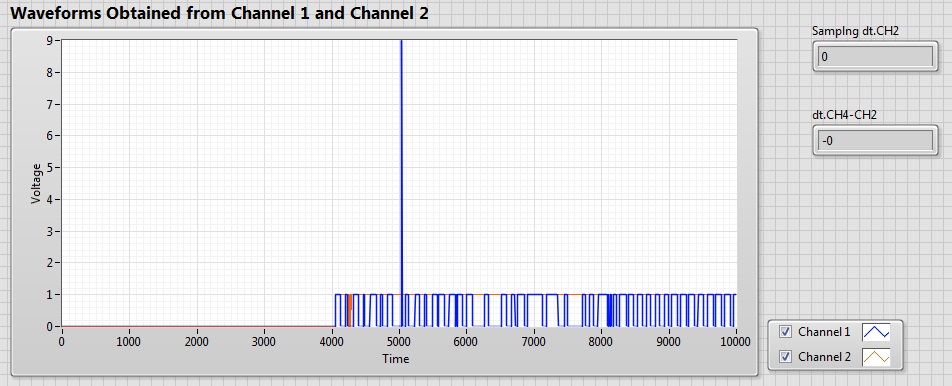

Lynn, thank you!Smiley Happy
Probably I need to run this VI on another PC because again there is something wrong with graphs or their settings and results are zeroes.

I have no idea what is going on when you run the VI. Here is what I get with the files you posted earlier.
I noticed that the subtracts in the dt calculations have their inputs reversed.  dt is not really negative.

Thanks very much! Smiley Wink It all works on another PC!
