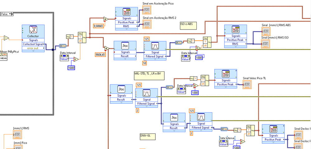

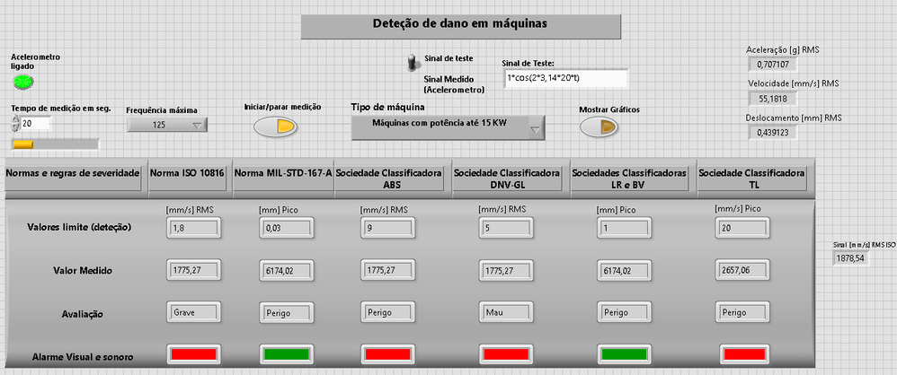

In Labview 2015 I'm making a program that I want to acquire the basic spatial 3/3/3 accelerometer phidgets signal in Peak values and RMS values in acceleration, speed and displacement according to the frequency bands established in the filters. In a case structure I have another way to acquire data, by a test formula and when I put the formula that is in the image below, the values in the line "Valor medido" are not correct.You can see in attachment. Am I using the most correct functions for that?Another question, how do you get the frequency and amplitude of a waveform formula automatically when you run the program, without being a numeric control? where am I going wrong? Another question, how do you get the frequency and amplitude of a waveform formula automatically when you run the program, without being controlled? I've made the calculations on a sheet of the relationship between Peak values and RMS that I put in the appendix.

You have two controls with the same name "sinal RMS ISO", it's confusing. Try to clean your wires too ; they should go from left to right and as straight as feasible. If the VI becomes too big, use a sub-VI.
Then can you post your actual VI files please ?

I think it's better now.
Now the values in [mm] positive Peak are getting negative. You can analyse in the attached VI please.

Your code is wildly "disorganized" -- everything seems to be in one (very large) Block Diagram, wires and numbers everywhere, almost impossible to follow the logic without having you "walk us through the Forest".
I recommend that you do a small simulation.  Use one of the Waveform Signal Generation VIs to make a signal with noise.  Add the VIs you want to use to analyze this single, simple signal, make the plots, and attach that VI (without zipping it or compressing it, so everyone can open it if they have the appropriate version of LabVIEW).  Who knows, you might even figure out, yourself, where you are making your mistake.

Now it's better organized. And as you suggested in .Zip format, but I can't carry it so I put it individually. The program is Interface novo 1.Vi

As I explained before, I'm using Labview 2015 to create a program that acquires the signal from a accelerometer Phidgets spatial 3/3/3 Basic in acceleration, speed and displacement. I have a test mode, with a formula in a case structure. which can be seen in the attached image. The RMS values and peaks on the Line "measured value" (on the front panel) are not correct for that test formula that I entered. I made the calculations by hand of the relationship between peak and RMS and do not give those values.
Can you analyze it in attachment please?
