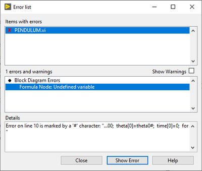

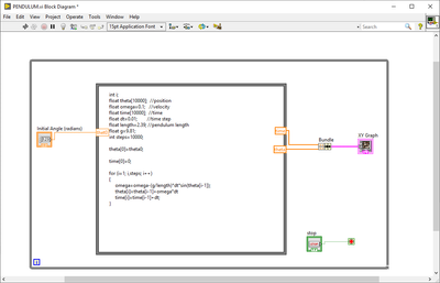

Hello, this is some C code I inserted inside a formula node for a pendulum. It comes up with the error shown in the second screenshot, and I'm not sure what to do about it as I've copied exactly the code from a manual we were given.

What about that missing variable "theta0"? It isn't defined anywhere in this formula node!
(Check the naming of the formula node input carefully…)
