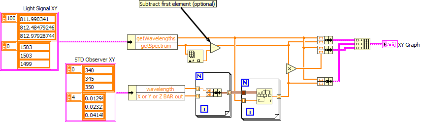

yes I am basically using an XY array, there are two 1D arrays bundled into a cluster to view them on a graph. the X data comes from the instrument and is an array ranging from around 330 to 800 (nano meters).
Attached is a sample of the light signal XY data (1024 samples) and a constant I've called the "Standard Observer XY " (99 points) used for part of a calculation.  Both have different start and stop X points (wavelength) and different sample rates.
In this case i would want to multiply the two sets of data, but the number of samples needs to match and the values of x would also.  So missing data needs to be interpolated.  Ideally in the end i would end up with a vi that takes any input waveform and spits out a modified waveform that fits a definition ( startX, stopX, XstepSize).  this way the same vi could be used as a "Wave Form Manipulator.vi" to preconfigure each waveform before starting any math on it.

Accepted by Tim30
See if this works for you.
(Just a very rough draft. Modify as needed.)
Message 5 of 8
(4,447 Views)
Maybe I'm over thinking it and needed some lunch...  Here I used "linear interpolation 1D" to make the best guess.  I tried using interpolate 1D Array without much luck...  Guess I would just fit one curve to the others "X array" (Xi) to create the new Xi, Yi that has the matching sample times.  and chop off anything below the specified Xmin and anything above the specified Xmax...

Ya this works great.  Actually it gives the exact same results as using "Interpolate 1D.vi" except for the trail off at the end..
If anyone wants it, attached was the final check of the two methods.
