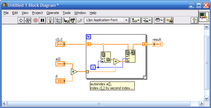

Looking at the for loop where N=3: I need that y value that is connected to the shift register to get updated to the c1[j,i] array (using the index from the loop iterations), I cannot connect the second shift register to the array though.

This technique gives me the proper array in the 'result' array, however that does not really help me, I need that 'result' array to update the c1[j,i], this way that array gets updated each successive iteration.

Hi cmersit,
why do you need that? You did not say so before...
Well, create a local for c[j,i], move it into the for loop and connect it with the output of ReplaceArraySubset. It will hurt memory needs and processing speed and doesn't serve any purpose here. Replace result[] with a local of c[j,i] for this very example. Otherwise use a shift register in the outer loop!

The reason I need to do that is because I am using sequential batch training to train a neural network.  The c[j,i] values are being updated each iteration based upon the sample 'training' data, then once every iteration is complete the 'weights' are updated (initially starting with random weights) and the overall error function is computed.  I basically keep doing that until the overall error function decreases (epoch after epoch), and I get desired weights that will give me the proper outputs when I give the network inputs.
I will try the local and let you know how that goes.
Thanks for all your help!

It worked beautifully!!! Thank you so much for your help GerdW!!!
