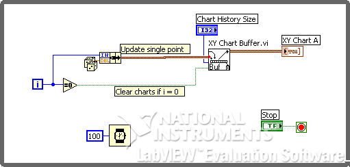

The example called XY Chart does exactly what you want if I understand correctly. You just need to change the data that is being written.

Whoops, wrong vi Smiley Mad  I based this on an example and fell into the File -> Save As trap and modified the one in the examples folder.
Here is the right one
Sorry about that
David

The example I mentioned doesn't use a chart. It uses an XY graph. Open the example I mentioned and take a look.
