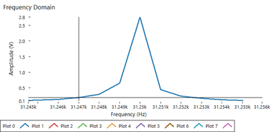

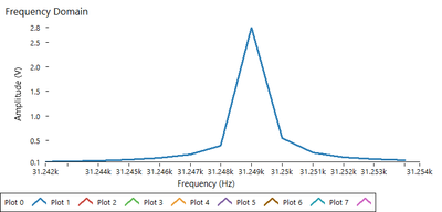

  3. When I set the loop rate to 250kS, this is below 345kSa, I should have a square wave that has a frequency of 31.25kHz. But when I look at the data, I get 31.249kHz. See belowFreqOFF.png

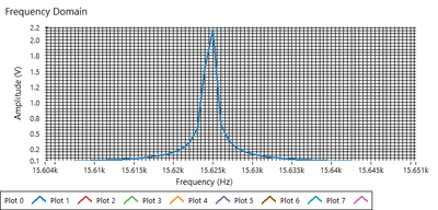

If I change the update rate from 250kSa to 125kSa, then I get the right frequency, 15.625Hz, although the peak is slightly distorted.FreqON.png

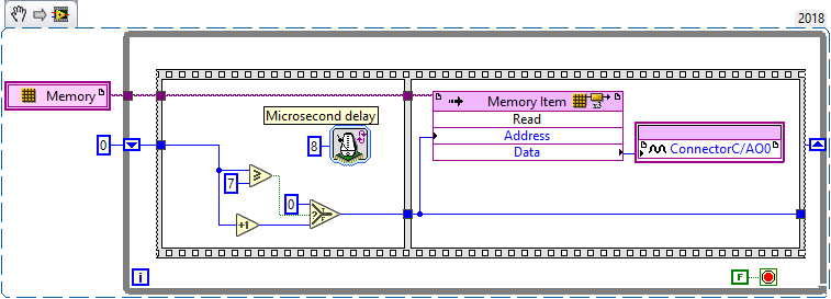

Took 100s of data, did an FFT to get an accurate frequency. I got 31.24915kHz, instead of 31.25kHz. This implies the 40 MHz clock is running at 39.9989 MHz, this is greater than 10ppm. Is that value typical? (do not see in on spec sheet)

I think you're going to get some issues using the delay like that. Outputting to AO takes some finite amount of time, so with the sequence structure you'll be waiting 8 µs, then [AO write time], then looping. You're guaranteed to get something slower than your desired loop rate. It may not be significant (I don't know how many clock cycles it takes to perform an AO) but it may be worth looking into.

I went back to my original thought, the 40MHz clock in the FPGA is off, that is, not really 40MHz. Luckily I have 2 additional myRIOs in a box to test. The first replacement gave the correct frequency with my original simple program. See below.FreqON.png
The peak is still not symmetric, but better than before.

EDIT: Just did a 10s FFT got 31.2498kHz instead of 31.250kHz, only off by 0.2Hz, instead of ~1Hz.
Writing to the AO will take some time but the Loop Timer function should handle that, just so long as the entire loop execution takes no longer than 8µs. For example if the AO write takes 1µs the loop timer should only wait 7µs, keeping the loop running at the correct rate.
