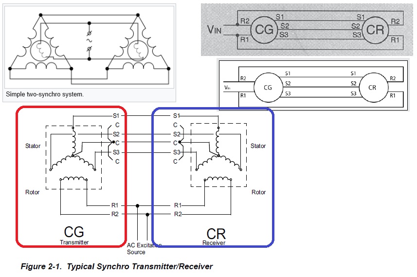

Ah... you've hit the crux of my question.  We are simulating a Torque synchro transmitter (CG) with our DAQmx / hardware... because we are driving a Receiver synchro (CR).  This is extremely common requirement for my industry (flight simulators).  In real aircraft they have 400Hz excitation, and they have both the transmitter and receiver synchros paired... aka self synchronizing (selsyn).  But in flight simulators, we don't have the transmitter side... but we still have to drive the receiver side.  The receiver side is typically what is used to drive the needles on gauges in the cockpit to a correct angular position.  So unlike 99% of the NI folks who perceive synchro's as angular measurement devices only... there are tons of flavors and uses of synchro's, and angular measurement is just one.  Driving the rotor to a particular-specific angle is a really common and important other use case which is generally not even considered on ni.com. Again... I'll hold my question statements to the end of this post.
Message 23 of 34
(5,839 Views)
Okay... so it seems that hitting reply puts my comments at the end anyway, instead of just below the statement that I hit reply on.  sorry for the confusing 3 posts at the end.  But here's my question....
We need to simulate a Torque synchro transmitter, aka CG.  I've pulled figures from various manuals like Wikipedia, the moog synchro application handbook and edited it with my pretty colors to avoid any infringing...
As I stated previously, in the flight simulation world, we mainly need to drive needles on gauges... where the needle on the gauge is mounted on the rotor of a Receiver synchro (CR).  So we need to drive that CR to a known angle (q).  The math I've found is straight forward and easy to implement:
VS1-3 = Vex sin (θ)
VS3-2 = Vex sin (θ + 120°)
VS2-1 = Vex sin (θ + 240°)
where:
 q is the angle we are going to drive the needle to (which we figure out elsewhere in our simulation code)
Vex is the excitation voltage which is usually 400Hz for aircraft, and in our case is 90VAC, but we've got transfomers to step it down.
Our plan is to use an AI (a cDAQ NI 9221 8CH AI... not simultaneous but see previous post about DAQmx Timing Properties to mimic simultaneous sampling) and 3 AO's from a cDAQ NI 9269 4CH AO.
The trick is that the best way to read in the Vex AI to get the excitation is probably either a continuous sample (?).  But since I know it is 400Hz, I might be able to do a buffered analog triggered acquisition on some threshold voltage... (?). OR it might be best to do a single sample, and do the math point-by-point...
Regardless of how we get the excitation voltage AI input... I then need to generate the 3 output signals.  Again, I've thought that this might be best done point-by-point... but with various transport delays (cDAQ AI to 9188 chassis to Ethernet to my PC NIC to my LabVIEW application's math, back to PC NIC, Ethernet, 9188 chassis to cDAQ AO... that may take too long.  Not sure what the turnaround time is yet as I haven't been able to purchase hardware and test).  Alternatively, I could have some buffers of sine waves built up, and then do a buffered AO (?)... or... maybe continuously output various sine waves (?).  I'm looking for advice based on any practical experience.  Does building up buffers and then changing the AO waveform cause a glitch between one period of the wave and the next?  There are a multitude of VIs available on the Signal Processing > Waveform Generation and Signal Processing > Point by Point on the functions palette in LabVIEW.  I think I can figure out how to use each tool individually, but I'm looking for some advice on a good overall approach.  So far in other posts, I've only seen people attempting to solve this in cRIO or with North Atlantic Synchro cards.  In the past we've used UEI's Synchro cards and VME Synchro cards, and this the first time we've given NI equipment a shot (at this company) and we've hit this Synchro design issue and are looking for best practices and advice before purchasing.
Thanks in advance!
