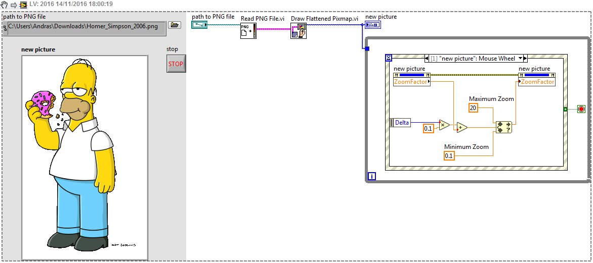

The problem is that you create your 2D Picture control in the wrong way...I guess.
I downloaded a png/jpg file from internet, and I follow the description here:
http://digital.ni.com/public.nsf/allkb/328AF568F15B36328625696200511EF0
Then, I change the 2D Picture indicator into a control, and I set the actual value "as default".
Finally I placed this new 2D control into your VI, and the zoom function just works.

Or just do all in one step:
edit: I think you tried to customize the 2D Picture control, yes? So your picture became part of the customized control, that is why it cannot be zoomed. So it was not stored as data in the control, but it was part of its "decoration", like a background. This is what you tried? Anyway, if you follow the description what I gave, you can create 2D Picture indicators/controls with any picture saved with it "as default"...

🙂 I advice you to go through some LabVIEW tutorials, so you would learn what is indicator/control, etc...
Anyway, the VI what you show is OK. You just tried to do the things in the wrong order. First use the 2D Picture control as an indicator, not as a control. A wire cannot "flow in" into a control, but in an indicator. So change that 2D Picture into an indicator first (right mouse click, "change to indicator"). Browse the file you want to load, then run the VI once. You should see the picture now in the 2D Picture indicator. Right mouse click on the indicator, and select "Data operation" --> "Make current value default".
Now you can copy/paste this indicator into another VI, or you just in the actual VI (see my example snippet). Either you can use this as indicator (the zoom feature also works), or as a control in your application. If you want to change dynamically the picture during runtime, just keep it as indicator, and inside the While loop. One Event case could be dedicated to a "Load picture" command...Well, all depends on what is your final goal...
