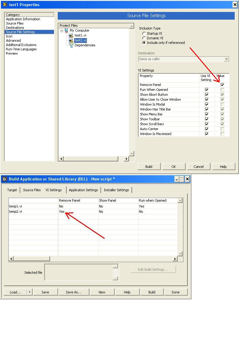

      If the compiler doesn't think an FP is needed, based on a VI's appearance properties, it will exclude the VI's FP during compile - and FP.Open won't work for the VI.  The attached pic shows this compiler setting in 7.1 and 8.2.  If the VI is top-level, or one of its appearance-properties indicate the FP is to be shown, these will default to UNselected for remove, otherwise you'll need to deselect these for Open FP to work.
