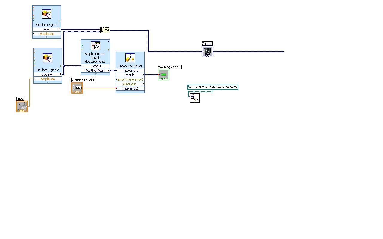

I am trying to get labview to play a sound as a warning message when a value is exceeded. I can get a Boolean LED to light on this condition, but the sound file plays all the time. It needs to start when the LED lights.
Where can I wire the sound vi to, so this condition is satisfied - See belowLabVIEW Sound.JPG
I am using Labview 8.2 Student
Any Ideas?
Cheers

palce a case structure in your BD and out your sound file code into the true case. Connect the "Warning Zone 1" value to the case structure, so the sound plays only if this condition is true. You have to convert it to a boolean value first.
Mike
(5,006 Views)
As Mike explained, you will need a Case Statement and some condition to play the warning sound.
At the moment, the warning will play everytime, quite possibly at the beginning of execution of your code.

I leave an example that can provide, use it in your program
