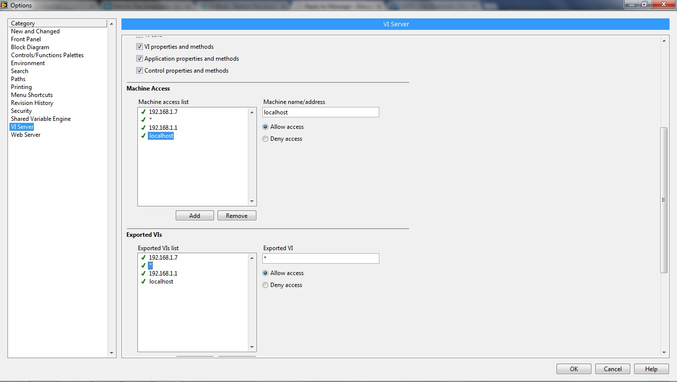

I am trying to download the Arduino package from the VIPM and they won't seem to connect. I have included a picture of the error and two more of my settings. I am using the student evaluation of the Labview software, but I'm not sure that it is what's causing the problems. Any help would be appreciated, as I would like to set up a nice GUI using labview and an arduino as my DAQ device. I need this for a project for my professors so I am rather desperate to get it up and running.

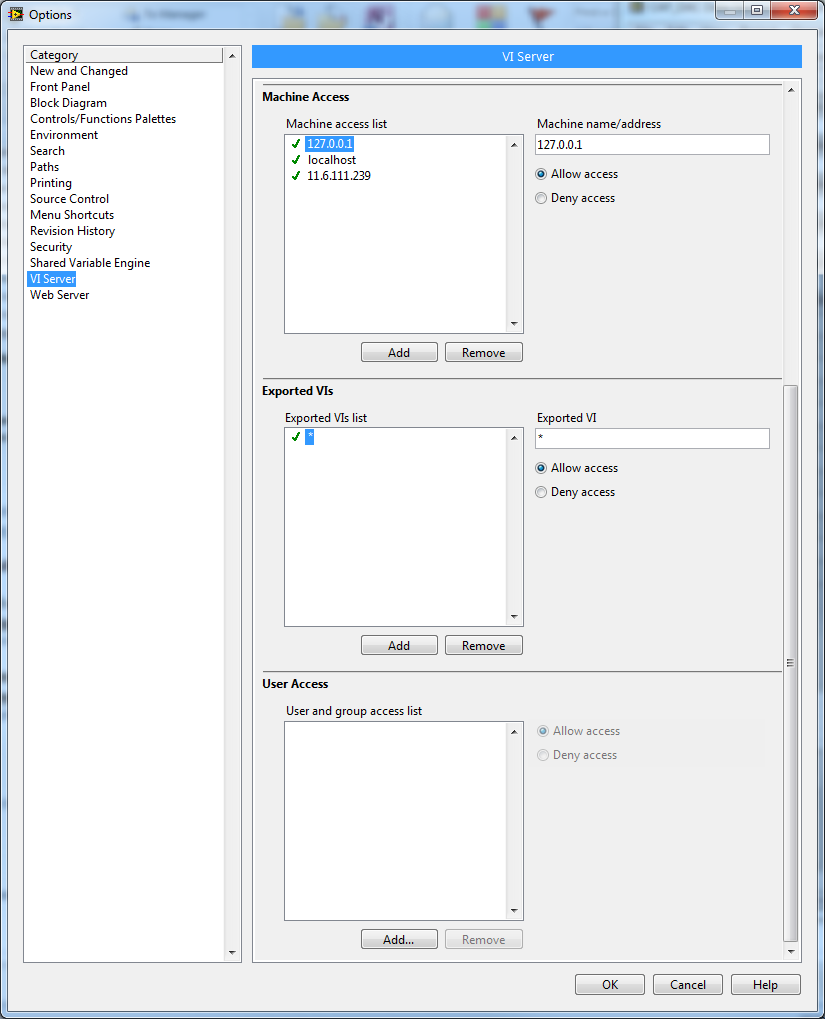

Try it like this but with your actual IP address instead of mine (11.6.111.239).  Make sure to include 127.0.0.1 as that is the Wiondows (I'm assuming here you're using Windos but you didn't say) default for local machine.

Ill give it a shot and post the results thanks for the help.

No, i tried using you settings and stil not working. i went through every combination of the four items I have on the machine and export list. Still nothing, do you think that its that i amNew Labview settings, not working.png using the student version?

Clear your Exported VIs list of everything except the asterisk (*).  Your Machine Access list should contain ONLY 127.0.0.1, localhost, and your machine IP address; delete all other entries.  Clear all entries from the User Access list.  After you do that restart LabVIEW.  Then try running VIPM.
Do you have administrative rights on your machine?  That can affect this.
