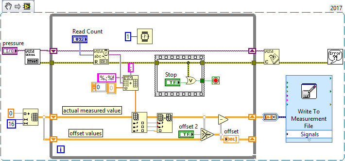

Accepted by topic author PanR
Sorry about that, I didn't even notice the LabVIEW code.
How does that code not work? I think it does pretty much what you describe. If you press the button, the current values will be zero, and subtracted from new values.
Do you want the first value read to be zero? If so, I'd initialize the zero value buffer with NaN or -inf, and then fill the zero buffer value if it's previous value is NaN or -inf. Alternativelly, you need a third buffer filled with Booleans to keep track of individual zeroed values.

Thanks, One more question, what kind of Mechanical Action should I choose for the " offset 2" button ?
Message 6 of 20
It should be latch action (not as currently in the snippet above) and in addition. It should have a more intuitive label.
(Also, should the "read count" really be 9600 by default???)

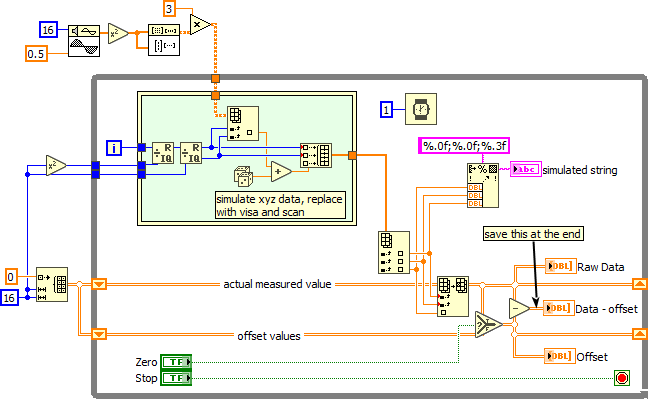

There are two issues here, and it is not really clear what you want.
I assume you are constantly reading the pressure sensor, but if you don't touch it, you want the current reading, whatever it is due to e.g. miscalibrations or limitations, to be zero reference (.like e.g. tare-ing a balance).
This means you need to keep that reference in a second array. Basically after you do that, you want the difference between the current reading and the reference to be zero so if you touch the sensor later, you'll get correct relative reading.
The attached example will give you that. See if it makes sense to you.

@altenbach wrote:
Isn't \n termination enabled by default? If so, 9600 read count would work if the data is indeed \n terminated.

I use your Code in Labview. But it Show 0 first in the corrected Matrix then it Change to negative value. The value  in the corrected Matrix Keep changing and never stop.  when I press zero-offset button, I want to keep the corrected Matrix is 0. How should I make it?
Picture 1: LabVIEW Code
Picture 2: After I press zero-offset button and how it looks like
Message 10 of 20
