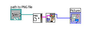

Thats a help file job - not difficult.
Use customize control and transparency to get rid of the border round the picture.
