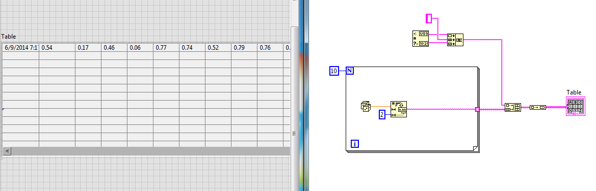

1) how to plot array horizontally on Build Table ?
2) how to change Date/Time realtime same as PC Date & Time on Build Table ?
this is my screenshot
Message 1 of 10
(5,861 Views)
You have to obtain the computer time at the time the values are created (each individually). See the attachment for a solutions using primitives.
A curious question: Where did you find Build Table Express VI? I cannot ind it when searching for a VI.
Message 2 of 10
(5,839 Views)

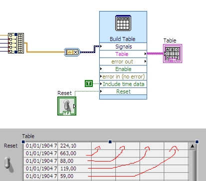

Hi ghighuphu,
Sorry for delay to reply, its almost like what i want but i mean the time&date is just one column on the left column, and the data on the right of time&date column.

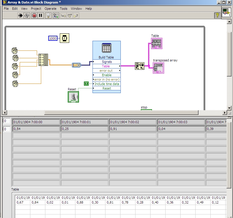

Transpose the array before you wire it to the indicator.
Message 4 of 10
(5,791 Views)
Hi Ravens,
i tried it but still didnt understand, the data turn right one by one, sorry for my bad experience on Labview

There is only one other possible outcome 🙂 Do you want the data row first and then the time row second? Then you have to separate the two lines (array elements) and change their order (concatenate arrays).

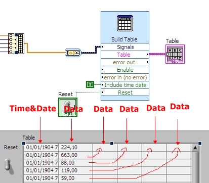

Hi ghighuphu,
Right, that exactly what i need. so the data will be like this
| Time&Date | Data1 | Data2 | Data3 | Data4 | Data5 |
did you get it what i mean ?

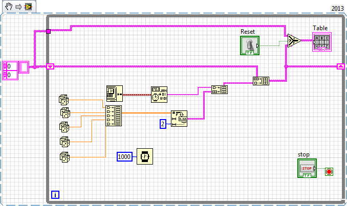

The corrected answer as you required is attached is as follows.
But this code will not add for new date. you will require a while loop and shift register to check if the date has changed for further modification.
The above code works perfectly as per your requirement.

This is one of those times when the express vi is really being used as a "Screw-Hammer"  It is not intended to do what you desire.
Try this
Message 10 of 10
