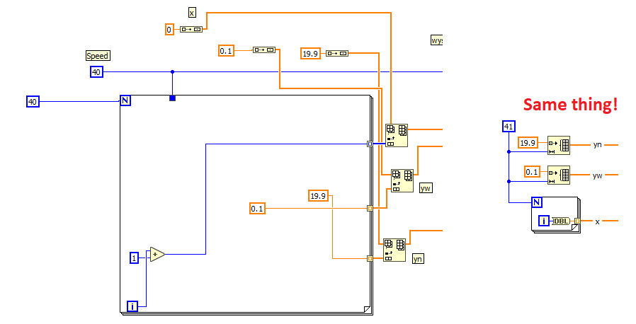

You did not attach your image, but I am sure that your code could be streamlined dramatically. For example, you are constantly resizing arrays while a simple "rotate array" might be sufficient.
You need to familiarize yourself better with array operations. As a small example, let's see how you initialize your arrays and how it could be done instead.
Also note that some of your diagram constant are scattered all over the the diagram with the same values. This is a nightmare if you event want to tweak the values a little bit. Exactly one diagram constant for each value is sufficient!.

Thank You for Your answer. Yes, I'm aware of that, my experience with this kind of programming tool is far smaller than I'd like to. Unfortuanately, this is a project I'm ought to accomplish, therefore I'm doing as much as I know. You are right though, I'll try to optimalize it a lil' bit :). Have you got any clue how to do something about my problem?
(3,314 Views)
I am not sure if XY graphs are even needed. All your pixel positions are integers so there is no need for floating point calculations anywhere. I would probably try to do everything in a simple 2D picture indicator.
