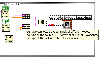

I want to plot some data from rs232 to a chart with a time based axis. I made something like the example "Variable-time Chart XY" but im getting an error : "connect 1-D array cluster of 1 element to sink cluster of 2 elements".
What shoud i do to fix this?

You have two different types wired to the same waveform graph.
You have a cluster of DBL/SGL/SGL/SGL/DBL and an array of clusters[SGL/DBL].

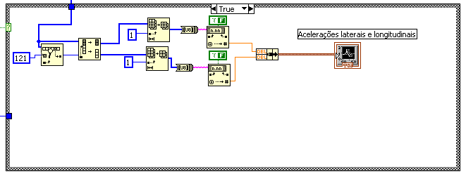

I want to plot data to chart with time axis,
I made this and its ok, but now i want to show time on X axis.

Problems:
You have a race condition.  Two sets of values being written to the same graph in parallel. I realize that you want to send the X-axis seperately, but to what values are you associating those values to (on the y-axis)?
What does the data from the serial port look like?  And why do you use a byte array?  Is the data all binary?
If so, maybe the first step is to determine the start & end of a byte array and convert it into numeric.   You read it in 12 bytes, why do you do that?  Can you ensure that it is the full / proper data frame?  Are there any delimiters or patterns to indicate start / end of data?
Why do you add zero to the strange timestamp?  0 does not change the value.  You're adding the strange timestamp to the data going to the graph... That's going to make things ugly..  Not only in the esthetics sense 😉
You should bundle the timestamp with the data in a waveform.  I would suggest a smaller number for the timestamp, but that might be a requirement that you are trying to meet.

ok, forget about the time problem and lets focus on rest first.
I have this:
Im sending many types of data to rs232 (XY acelerometer values, temperature, and others). in the chart example, i send from hardware something like "x%0.2fy%0.2f" where 0.2f is the value and the x/y is a tag that help me to know what kind of data is that.
So when i receive, firstly convert the string to an array and then i serach if the first position of array is an "x", if so then i know that string has data that i want to plot on chart. It enters on a case structure and then i split the array to "x%0.2f" and "y%0.2f, i remove the "x" and "y"and convert the data to decimal string to plot on chart.
This is working fine, i belive there are many easiers ways to do this but im begginer with labview:smileyhappy:!
Ok, now i have 2 plots on the same chart and i want to set the X axis as current system time (HH:MM:SS,xx).
Thanks for your help and forgive me my bad english Smiley Sad

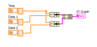

You can use an XY graph and get what you are looking for. See blow
Tim

and how i get the time ? with the get data/time string of timing palette?
Message 8 of 23
(6,161 Views)
That would work.
Tim
GHSP

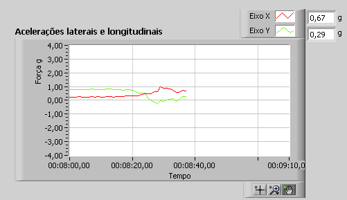

u mean this ?
