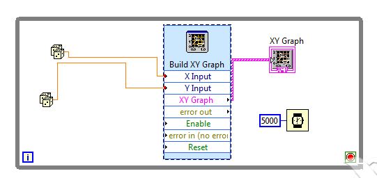

Plot xy graph using random number generator
How do i plot xy graph dynamically every 5 seconds with a random number generator?
X axis : Time
Y Axis : Random number generator

I probably would use LabVIEW.
What have you tried so far? Where did you get stuck?

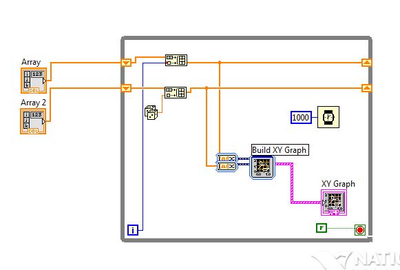

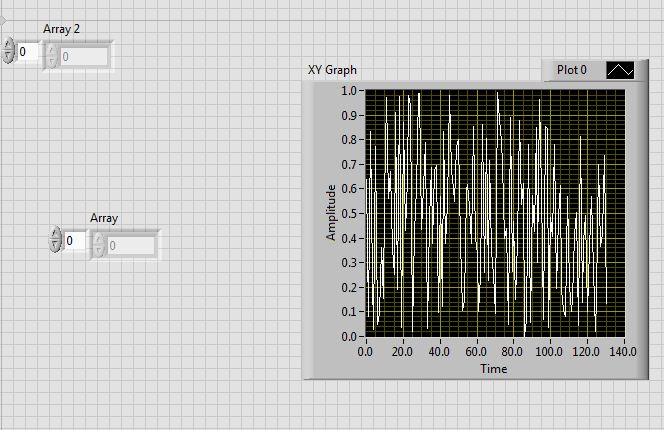

I've done tis so far. im able to plot dynamically every 1 second.
but the problem i am facing is The X axis display every 1 second.
i want it to be fixed 24 hours time format, and the data will gradually plots the data on y axis against x axis every one second, without changing the scale of the x axis (24hour time format)
(7,706 Views)
You don't need shift registers and the Build Array because the Build XY graph express VI is doing that for you.
If you want time on the X axis, then you should be putting in the time, not another random number.
If you want to change the format of your X axis, then turn off autoscaling and set the min and max to be whatever gives you 24 hours of data (0 to 86400 would be 86,400 seconds in a day.)
