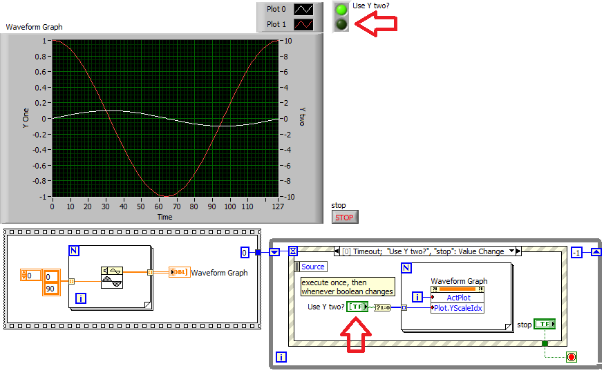

Property nodes execute top to bottom, so first select the active plot and then give it the desired y scale index. (make sure the selected plot and axis actually exist)

Here's what I had in mind. Modify as needed. (This is for a waveform graph, but the same applies to xy graphs)

That’s it!  Thanks a bunch.
