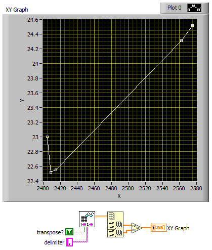

Hi russ,
it would help when you would attach your VI with your failed attempt…
It's quite easy to plot XY data:

Accepted by topic author russ_comer
Works just fine here. (What is your localized decimal delimiter?)

You did not define the delimiter as comma.
Your transpose is in the wrong place.
Why don't you place an array indicator after the read function to see what you actually get?

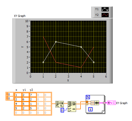

Given an array with N columns (x, y1, y2, ...yn), here's one possibility:
