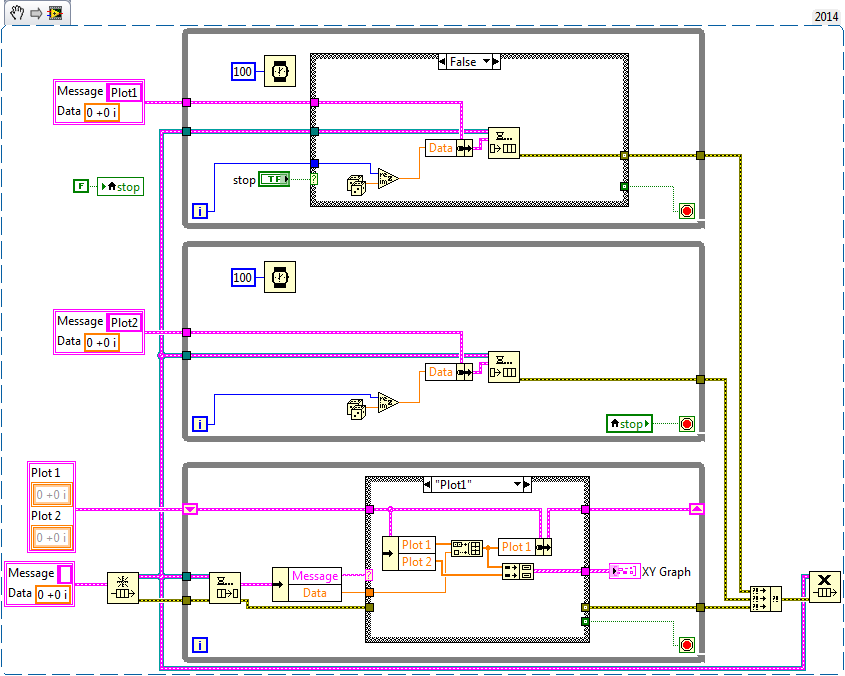

You can use queues to send data between parallel processes. I've made an example for you below:

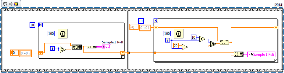

The real issue you are having is the express VIs.  If you open the front panels of them and dig into the code you will see that they are using local variables.  So express VI one builds 1 graph and it has a local variable and then the second creates a totally different graph and local.
I would suggest looking at how the express VIs add data to XY graphs and do it manually, at least in the second loop.
See the attached.
Note: I really think there are MUCH better ways to share the data from one sequence to another.  First off I would totally remove the read local and just pass the data from one sequence to the next.  So in your real applicaiton you may want to look very carefully at the local usage.

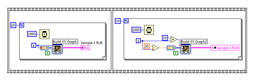

This is an image of the test code I attached, which is the simplest demonstration of the problem that I could produce.

You can do something like this. Is the second process just a continuation of the first? If so, it becomes even easier and you can just keep building array in the second loop.
