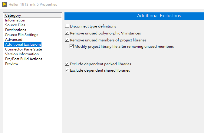

I have a project contain a parent class will dynamically load packed libraries from a folder named A.
If I build PPL of child class to B folder, and then copy the PPL to A folder, when the project load PPL from A folder, it will occur error1498.
But if I build PPL to A folder directly, it works and no error. I can't figure out?
BTW, when I build PPL of child class, I checked the exclude dependent packed libraries and exclude dependent shared libraries from additional exclusions as below
(3,048 Views)
ALL relative paths must be consistent at all times.  This includes your PPL that contains your child class to the PLL with your parent class.  So if you "exclude dependent packed libraries", you must maintain relative paths between the dependent PPL and wherever you build your new PPL to.
