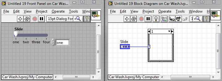

I am really getting frustrated. I know I have used slider controls wired to case selectors before and it acted like an enum. I could add cases for every value, etc. But now I am missing something and can not figure out how to do this. When I wire the slider to a case structure it acts like an integer is wired to the selector. I tried changing it to a typedef and that didn't work (I didn't expect it would)
Here are the steps:
  • Drop a pointer slide on the front panel from controls/modern/numeric
  • Right click and select text labels
  • Right click and select edit items
  • Add items "one", "two", "three", "four"
I noticed this is a type DBL so I changed that to a U16.
When I wire it to a case selector it does not behave like an enum. This is killing me because I know I have done this before. I am glad this is frustrating me on my CLD practice exam instead of the real thing!
I can right click on the control and create a constant. It creates a thing that looks like an enum with all the items that I added.
LabVIEW 2012

The only resolution is that I think I must have been imagining things.
It has been a long time since I have used any sliders or knobs with text labels. But I seem to recall that if you select text labels and add some items then you could wire the slider to a case structure and select based on the labels just like an enum. Maybe not. I know that if you create a constant from the slider you edit it the same way as an enum constant - it shows the labels. Maybe that is why I thought you could just wire it directly to a case structure.
