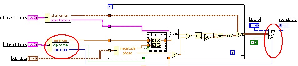

Hi. I have the problem. How can I create two different colors for two different plots?

The polar plot vi draws two images, the grid and the actual plot by using a vi called draw multiple lines.  Unfortunately, the function that draws the polar plot only allows for a single color, as shown in the image below:

Perhaps you could move the draw multiple lines vi to inside the for loop. Replace it with a draw line vi. Feed the picture around the loop with a shift register and write to the same picture multiple times. This would let you use the color input to the draw line.vi with a different color for each iteration. Might have to manipulate or reorder the data that you are sending.
Also see this thread.
http://forums.ni.com/ni/board/message?board.id=170&message.id=134753&query.id=28545#M134753
