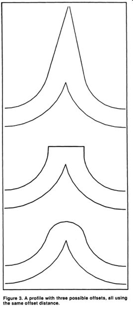

I need to Offset the Polygon as described here.
Message Edited by battler. on 05-26-2010 07:27 AM
Ah, now we are getting somewhere. It's all in the right description! This looks quite fancy!

A common method is to use a Minkowski sum of two polygons (the main polygon P and another offset polygon).  Basically you run the offset polygon around the outside edge of P and use convolution to create the new polygon with offset.
It is tricky to implement a robust algorithm using Minkowski sums especially with floats.  There is some example (although incomplete) code in "Computational Geometry in C", J. O'Rourke - an excellent text BTW - for a Minkowski sum between convex polygon and square offset polygon.
Anyway to cut a long story short, I'll post some info to discuss:
Message 9 of 13
(5,839 Views)
The problem is at the vertexes (both convex and concave) where the offset distance is enlarged.  Note that the Polygon in my application consists of straight-line segments.
