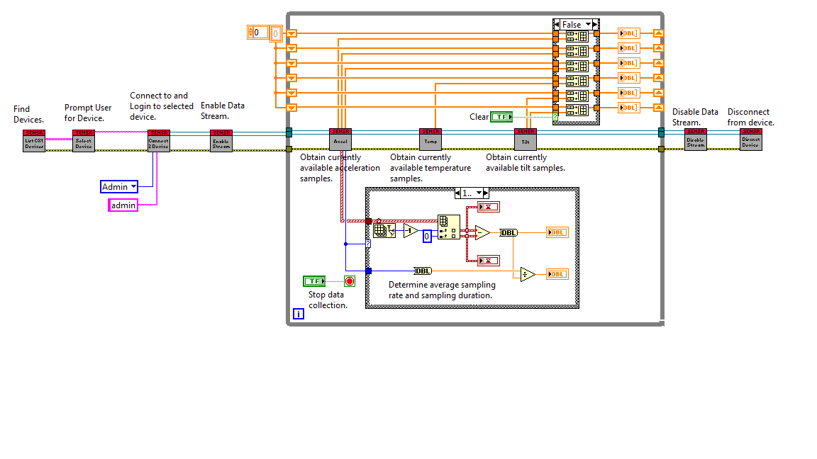

Pop up window problem in exe application
The problem is in "SELECT DEVICE" VI. In project it works well, but not working in EXE application.

You have no error handling and auto-error handling is turned off when you make anexecutable.  Slap on a simple error handler.vi to the end and rebuild the application.
[edit] additionally, for t-shooting purposes, put a shift register on the while loop on your error cluster so you don't miss anything.  After t-shooting, add proper error handling as the last thing inside your loop and then you can get rid of the shift register. [/edit]

In project it works fine. When we run project first we see a start-up VI then appear a pop-up window from subVI with choosing a device (SELECT DEVICE vi). After choosing and pressing OK button this window dissapear.
If we build EXE application from the project, and run EXE application than first we see a start-up VI then appear and lickety-split dissappear pop-up window from subVI (SELECT DEVICE vi) without choosing a device.

Ugh, you missed the biggest issue - automatic error handling is DISABLED when you build an executable so you have NO IDEA what is happening.
