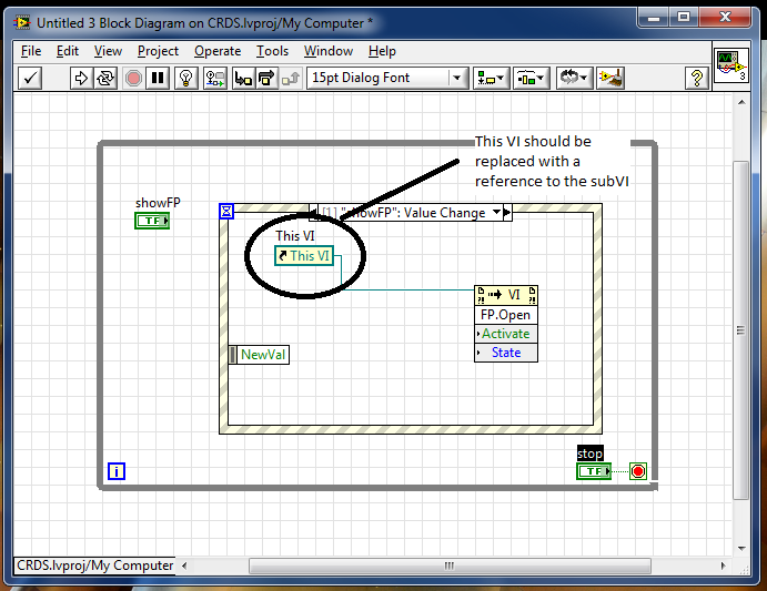

Why not just add a button that says "Show graph" (or something) and then just have an event that handles this by calling an Invoke Node with a reference to the subVI?  This will give you control over when you view it.
Message Edited by mtat76 on 06-11-2010 11:08 AM
(3,737 Views)
I may try not incorporating the while loop in the sub VI and just put it outside in the top level VI
