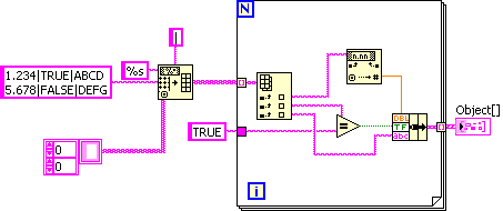

If there are several types in your file unit element and you want to use 'Spreadsheet string to array', the easiest way is to reformat your data as 2D String array and to work after line by line (or column). For example,
