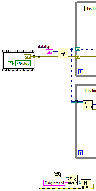

Hello I have Main Vi containing Many sub VI I set some of them to pop up when I press ok button, I set the subvi using VI properties to pop up when called. However it pop up and it is start to appear and dusappear very quickly with changing data from loop. What I want to do is to make that subvi controlable so I can close and open it easily and avoid the twikling window that happen to me now. I attached picure for part of my block diagram for main vi with subvi icon getteing the data from main vi to draw graphs in subvi.I hope this clear.

What you are seeing is by design (both LabVIEW and your code). The while loop cannot iterate until the subVI finishes if it has been called. Since you have it set up as a modal dialog, and to close its panel when it finishes, then it opens, writes data to the graph, and then closes, since that's all that's in there. What you need to do is to launch the VI dynamically so that you can leave it running while your loop continues.  This means that when the popup VI is launched, it needs to keep running. I.e., it needs it own loop (though not a Greedy Loop). Your button would open/close the VI. Or, you can just have the button on the main panel open the popup, and have a button on the popup to close it (or just use the "X" button in the top-right). You can pass data to the VI using queues. Examples ship with LabVIEW on launching VIs dynamically.
Alternatively, you could have a separate loop for each popup VI, also using a queue to pass data.

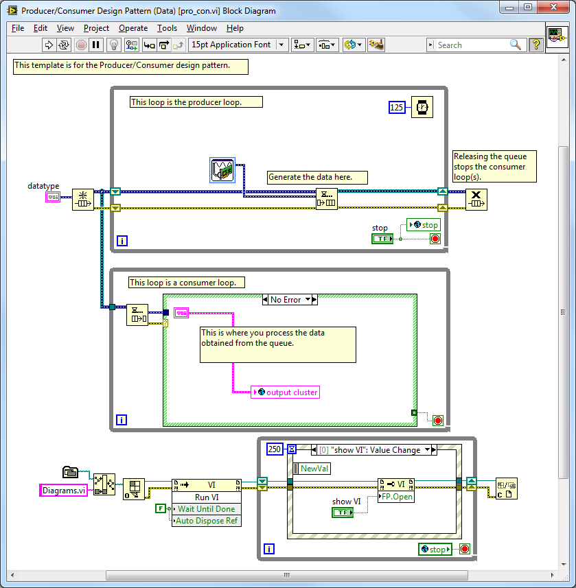

In the Producer/Consumer architecture, you would ideally keep only the production of data (i.e. DAQ Assistant in your application) in the producer loop. This will ensure that the processing (or "consumption") of data (i.e. all other operations like writing to file and analysis in your application) does not affect the acquisition of the data. It is also important to use the error clusters of the queue functions - and correctly remove the queue from memory (Destroy Queue) - this is also used to stop the consumer loop (when queue no longer exists) by default.

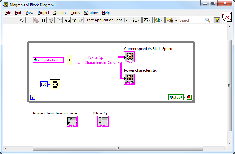

However, it sounds like in your application you want the data in the sub VI to be continuous, rather than updated only when it's visible. For that reason, I would think that a global variable may be the best option here. I would recommend using it in addition to Producer/Consumer loop architecture. With the use of variables you want to first be in command of any potential race conditions and check whether multiple sources write to the variable. If you're only writing to the variable in one part of the block diagram (yes in this case), using a global variable shouldn't cause any issues and we don't need to worry about locking 'critical' sections of code. You would want to write the data (and stop button value) to the global variable, and then read it back in your rather funky-iconed sub VI, as well as add in a loop to do that continuously.
The bottom part of the block diagram first gets a reference to the sub VI (using application directory to look in the same location) and runs the VI - you must set the Wait Until Done flag to false so the sub VI operates continuously. Use an event structure to display the front panel while the button (on the front panel) is pressed. Remember to destroy the reference at the end!

I talked about race conditions and then forgot to initialise the stop variable myself! You would want to write a false value to the stop variable before going into any of the loops to ensure none of them read "true" from the previous run of the application before the producer loop sets the value to false. Required modification:

This exactly what I need, thanks alot Imtiaz now the popup window working perfectly. realy this great help
