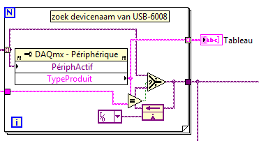

Hi gautierdufourcq,
Your VI works fine on my computer (LV2013 SP1 /  W7 64bit  / version 9.8 of DAQmx. I have the following behavior : if the NI 6501 is plugged there is no popup message and if it si not connected I do get the popup message.
Just to make sure I understand your problem : Is this VI the code that is not working on your computer2 (and working on your compteur1) ? When you execute it, you get an error because le VI does not detect the NI USB 6501, isn't it ?
If your add  an indicator on the "type produit" output, are you able to see your 6501 in the list.
Here is what I get when do it :

I don't understand that sentence : the NI USB 6501 is the measuring device. Can you tell a lite bit more about the purpose of your application and how/ why you use NI 6501 ?
Here is some tests that you can perfom on computer 2 :
1 - in NI MAX check that the NI 6501 is in the list of the connected hardware
2 - perform an autotest of the NI 6501 (in MAX)
3 - make sure your device work properly using the test panel in MAX
4 - then check in your VI that the NI 6501 is the list of the available hardware (see my previous message)
Let me know how it goes !
