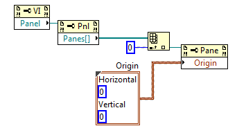

You have to implement something like this:
Norbert
Note that this code leaks references and does not work properly when using more than a single pane.
Norbert
