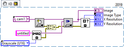

Here are some tests.  Rig up the 12-bit camera and have it look at a White card against a black background (or anything with a large contrasty "edge" to make it easy to tell if we did the Pixel-shuffling right).  Do a Snap into a U16 Grayscale image and see what resolution is reported.  Also look at the Image.  If, as you say, the images come in packed three Pixels in two Bytes, I'd expect the resulting visual image to look "messed up", and the reported Resolution to not be 224 x 1024, but probably 224 x 768.  If this is the case, then we should be able to "expand" the Image by transforming the pixels appropriately.  Here's a Snippet -- if you don't have LabVIEW 2019, you should still be able to find these functions and code this up.
