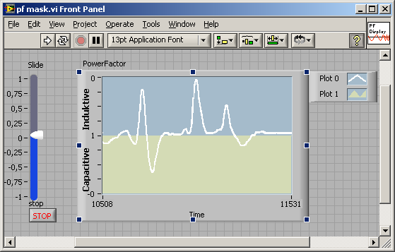

Whereever in the world you have seen such a power-scale?
What is the math behind it to (in limes) equal 1 to -1???
All you have is a phase angle! where the PF represents the relative real part of the complex power. BTW how does the powerfactor look like if your load (asume a motor) turns into a source (generator)?
However here we go
Greetings from Germany
Henrik

Yes, henrik you are right!
I know why but I couldn't made it in labview
could you attach your Vi, to 8.6?
I don't have the labview 2009 yet x(
Thanks!
and GerdW thanks for the example... for sure I'm not able to find it my self haha
I'm only a beginner!

So I the same type of issue with this, I have created the graph and the data to attach so that my raw data now fits perfectly onto the graph.
The issue I now have it putting that graph into a pdf report. Obviously when I convert the graph to image data it doesn't contrain the scale numbers that I have manually added for the 0,1, 0
I have converted the data as obviously you need the graph ideally to have 1 in the middle then have 0 at the top and 0 at the bottom but have it go minus -0.9 etc down. Anyway, i have solved the numbering, I just intersted to know if anyone has found a way of just taking a snap shot of an area of pixels on the front diagram, ie the area where the graph is and then converted that into an image to use on a report?
Would be very useful if anyone could point me in the direction of some code that does that.
