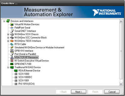

Can you post a PNG of the dialog box that doesn't seem to be working?

I was able to create a VISA TCP/IP resource for the Powerflex.  It doen't seem like its working though.  When I click "open VISA test pannel"  I get this error message:
Any idea what might cause this?
