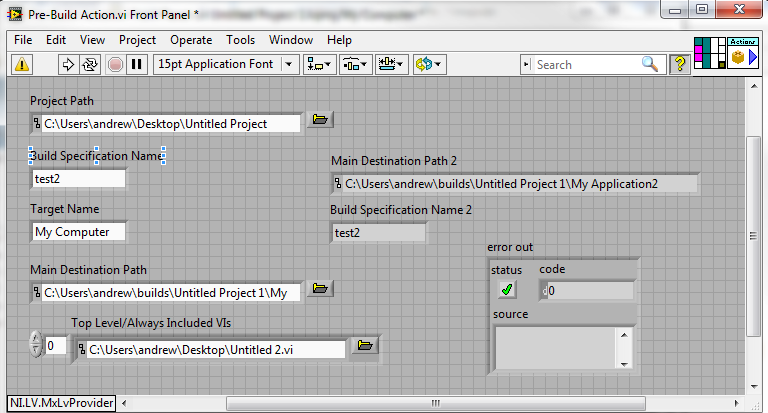

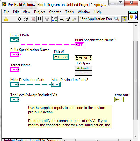

I did a quick test with a Pre-Built VI and the template that's created by the build spec already provides the two items you requested inherently.  I just wired up some indicators and forced the FP to show to test, but I'd imagine you could log it to a file or pass it into something else as needed.
This is with LV 2013 (32-bit).
