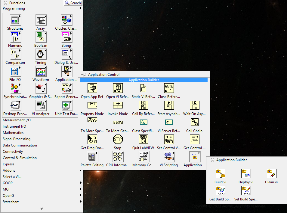

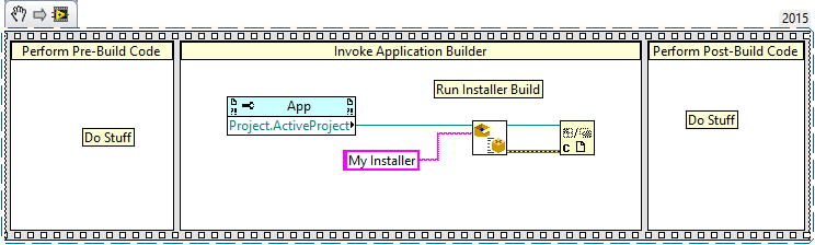

No, there isn't a built in way to do this as part of the installer.  However, if you have Application Builder the you also have the application builder palette.
With the functions in this palette you can create a VI to do the pre-build actions you want to do and then run the Installer Builder.  Not exactly built into the installer but really nice if you want to create your own automated builder.
