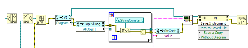

I do similar things with a version number of the build. I change the string constant in an FGV during bre-build:
Don't mind that sub-vi, it changes the VI icon to reflect the version number.
Regards, Jens
