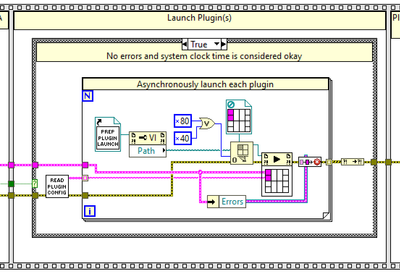

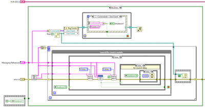

What I ended up doing when I need multiple instances of the same plugin is to dynamically launch the associated plugin launcher only once, which itself is setup for dynamic dispatch. The launcher uses parallel For loops to spawn however many instances of the "main" plugin code I need (in the picture this would be the FLIR AX8 subVI). That subVI is setup to be Preallocated and I *think* should accomplish what you're trying to do.
