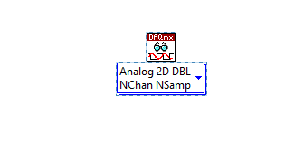

I deleted mixed graph and used waveform chart instead it worked.
But now I have a new problem, Although I have two channel only one the their value is right in the graph, second one is represented with minimum value (-10 in create channel vi). You can see it from pictures. For channel 1 i expect 6.8 and for channel 2 I expect 1,9.
I have litteraly copied the same code in order to be able to see 2 different channels. But it seems one of them is not working. I am using ULx library not DAQ.
And one more problem is X axes in graph which shows 9 digits number, I have unchecked autoscale and tried to change startin and ending point manually but it returns to that 9 digits number instantly, I need to see seconds there

With only one channel, I got the response I wanted (without filter graph is too noisy).
I am using ULx library not DAQ, it is possible to change functions in read function to 2 d DBL, but I couldnt find how to change physical channel to Dev0/Ai0-Ai1. There was no option like this, only single channels was possible.

Hi Natig,
With DAQmx you use the channel constant/control and select the channels as "ai0:1" (to select any channels from ai0 to ai1). I guess ULx handles this very similar…
You only need ONE task that reads 2 channels with "N samples"!
