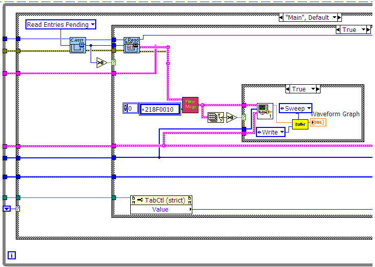

I am creating a program to decode CAN messages and display relevant information on screen in gauges, graphs, etc. The main program is a while loop that on each executing will check for new CAN messages. I have been forced to put each graph and gauge indicator in its own case structure, because if the loop runs, and the particular message that contains a corresponding value is not received, the graph or gauge will update anyway with a value of 0.
Wondering if there is a right way to do this that I am missing.

Can you provide the VI or a snippet so we can see the code?
It would be helpful for anyone trying to provide useful feedback.

Sure. Here is a snippet.

So the read function reads all values even though they're not all necessarily valid?  If that's the case, I'm not sure you have many options to change your program.  You will have to check the validity of each value before deciding to display it to the indicator which is what it sounds like you're doing now.
