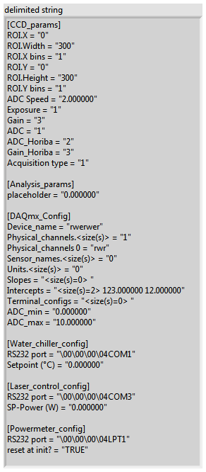

OK, actually using a simple EOL delimited string into a string indicator is acceptable, not pretty, but easy to read, see snippet below.
But my question is still, is there a good trick to avoid creating temporary file creation/deletion before we decide we actually want to create the ini file or not?

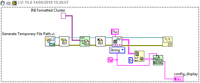

So I just proceed this way, to preview how the content of the ini file would look:

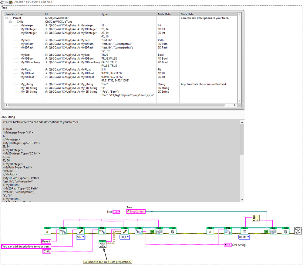

Actually I started to think, a Tree indicator could be a nice way to show INI file sections and elements/values to the user. Via VIPM I installed the NI Tree toolkit, and there is one example for XML files. I imagine, this could be adapted to INI files:
"Tree Data Types and XML Example.vi"
