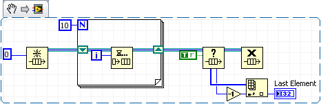

The Get Queue Status function has an optional input to Return Elements. If this is true, the function will return a preview of all the elements in the queue. You can then index out the last element in the array to preview the most recent thing put into the queue.
