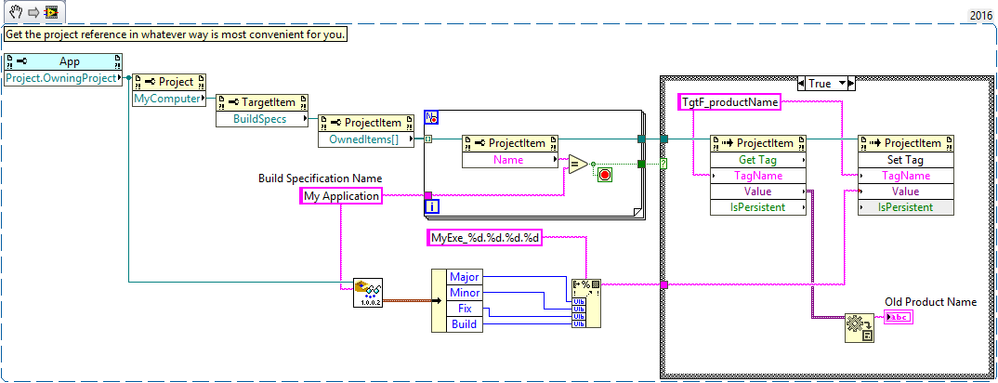

How did you wire the project reference to the Get Build Specification Version VI?  That VI (In LV2016) needs a project path, not a reference.
Message 4 of 8
(4,722 Views)
Haha, I have not dealt with this, but I wanted to figure out how to. That VI is polymorphic by the way. You can wire the reference in and it should change, or right click >> visible items >> polymorphic selector.
Message 5 of 8
(4,719 Views)
Grrr... I wish it was more obvious when a VI was polymorphic.
Thanks again!

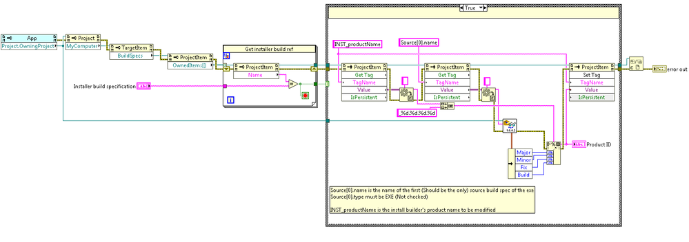

Here's what I came up with... I wanted to change the installer product name, not the EXE target folder.

A few more 'improvements':
  • Repeated builds no longer append version to version
  • Ties an enum directly to installer build spec name
  • Creates a zip file of the result for archiving
