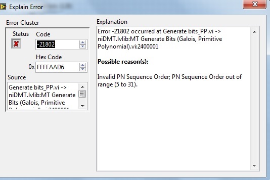

Screen shot of the error. Can anybody guide me how to fix this error.

I just simply want to know If I change PN sequence in to primitive polynomial then why VI gives error. I do not understand the reason of error and the explaination which is giving for solving the error. I just want you or someone to guide me what mistake I am making.

Since my primitive polynomial (1 + x  + x^4) which is in terms of bits 11001. As the labview help says it should be N+1 elements and N is define as x^N, which is 4 here so I have 5 elements which fullfills its requirement. But if you look at the error screen shot above it was related to PN sequence order. So when I open generate bits VI I found that in this vi first it measure array size and then subtract 1 from array. Since there are only five elements in the above polynomial so If I sub 1 it becomes 4  and generates error. So what I did I add one additional bit and make it 110010 and it works. I am not sure what I did was right or not but that's how I fixed it. If you do not mind please I request you to install Modulation toolkit and try to run this yourself and let me know what i did was right or not.
