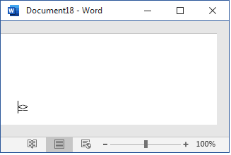

Having difficulty printing special characters to Word Documents using the report generation toolkit. I can pass the less than or equal to sign (using the font 'symbol') to the 'Append Text' VI, but it appears as the pound sign in the document.
Does anyone know how to get around this? Am I stuck using <=?

Didn't quite work... LabVIEW accepted Unicode characters without using the symbol font, but when printing less than or equal to, the Word Document received '  d"  '.

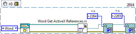

Here is a VI to insert a symbol into a Word document.  The character codes you need for <= and >= are 0x2264 and 0x2265.
